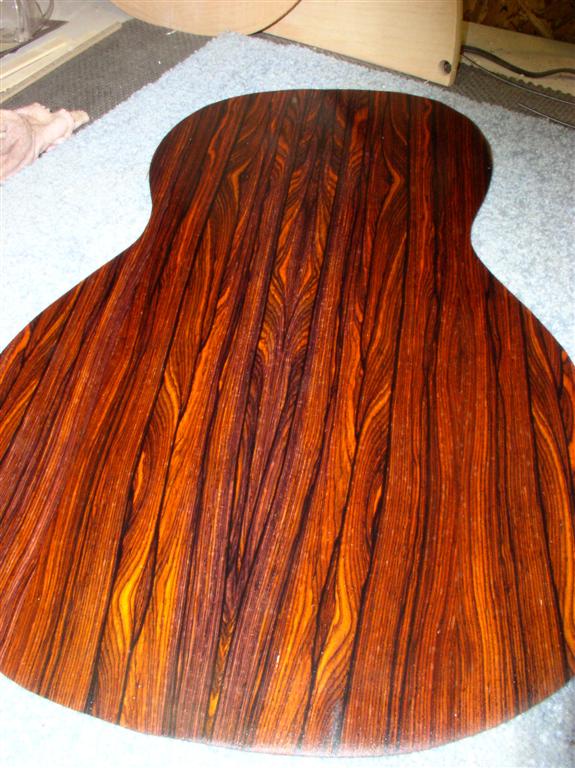

Kelby, you may have seen this, I don't know? But this is my first attempt at a four piece back, I think it looks great and have no problems about using it.
PostPosted: Fri Sep 29, 2006 12:54 am
Lance, I think you have a very fine eye for matching grain! Course it doesn't hurt that your back has more stripes than a Zebra!

Wow, Lance, that is spectacular!

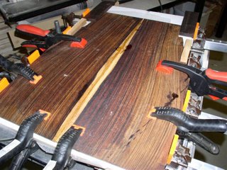

[QUOTE=LanceK] I use epoxy to glue these plates together[/QUOTE]
Ok Lance, technique question.......
when I glue plates I wrap top & bottom with polythene to stop the whole lot sticking to the table or the weight I set on top to stop it bursting upwards. (Ain't it great to get big blocks of heavy wood for free?!!)
How do you clamp with epoxy to keep it flat and not stuck anywhere it shouldn't be?

the point of the poly is to stop it sticking vertically.
never had a problem sideways!!
but ricepaper.
that'll work with epoxy too?

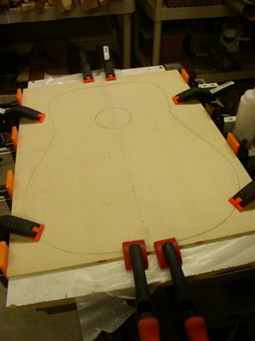

Martin, here is my set ups for joining plates,I use the same deal for back and sides.

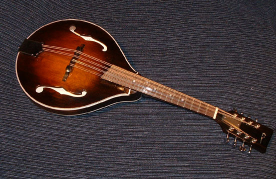

I think 4 piece tops and backs are fine. My first mandolin was made with leftover materials from various redecorating projects on my house. Like most wooden houses up here, my house from 1937 built with spruce (picea abies), and acording to the original owner it was actually logged at the property. So this mandolin has a 4 piece top that used to be wall siding, maple back, sides and neck from a door (?), the rosewood and ebony I probably bought.

Arnt, that was your first mando???!! WOW my friend, turned out real nice!
